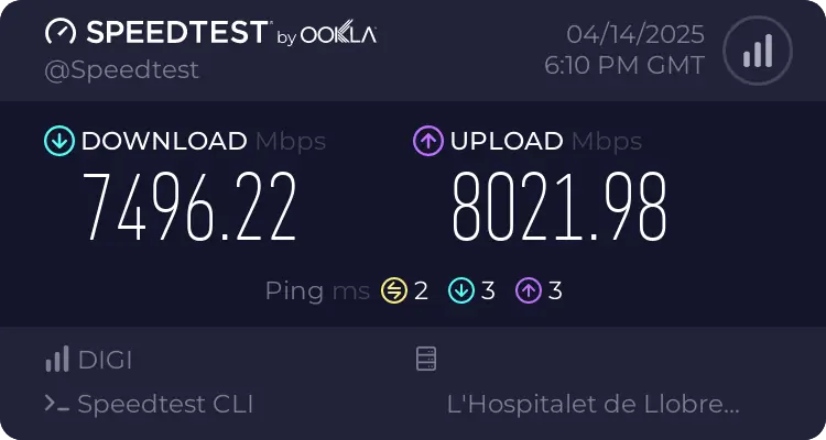

jotastars
Como que no?
Desde UCG Fiber y el XGSPON de FS. 0 Problemas y mejor que con el router de Digi.

Speedtest by Ookla
Server: Digimobil - Alcobendas (id: 51461)
ISP: Digi Spain
Idle Latency: 10.37 ms (jitter: 0.12ms, low: 10.21ms, high: 10.52ms)
Download: 8104.30 Mbps (data used: 11.7 GB)
  1. 96 ms (jitter: 9.77ms, low: 9.94ms, high: 505.51ms)
Upload: 5174.50 Mbps (data used: 9.1 GB)
  1. 98 ms (jitter: 1.91ms, low: 9.72ms, high: 255.24ms)
Packet Loss: 1.2%
Result URL: speedtest.net/result/c/871a8ec5-3603-431…46da2ca17674
Speedtest by Ookla
Server: PTV Telecom - Madrid (id: 6903)
ISP: Digi Spain
Idle Latency: 10.13 ms (jitter: 0.65ms, low: 9.89ms, high: 11.20ms)
Download: 7870.71 Mbps (data used: 12.8 GB)
  1. 42 ms (jitter: 0.43ms, low: 9.84ms, high: 27.32ms)
Upload: 3482.30 Mbps (data used: 4.8 GB)
  1. 91 ms (jitter: 0.80ms, low: 9.72ms, high: 23.81ms)
Packet Loss: 0.0%
Result URL: speedtest.net/result/c/ad86643b-4a16-45d…96844e6f37c2
