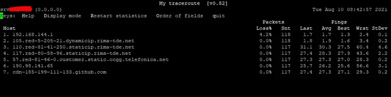

Vuelve a fallar, ya van 6 días.
$ ping -c 1 api.github.com
PING api.github.com (140.82.121.6) 56(84) bytes of data.
64 bytes from lb-140-82-121-6-fra.github.com (140.82.121.6): icmp_seq=1 ttl=42 time=36.2 ms
--- api.github.com ping statistics ---
1 packets transmitted, 1 received, 0% packet loss, time 0ms
rtt min/avg/max/mdev = 36.201/36.201/36.201/0.000 ms
$ ping -c 1 raw.githubusercontent.com
PING raw.githubusercontent.com (185.199.109.133) 56(84) bytes of data.
From 241.red-81-46-7.customer.static.ccgg.telefonica.net (81.46.7.241) icmp_seq=1 Time to live exceeded
--- raw.githubusercontent.com ping statistics ---
1 packets transmitted, 0 received, +1 errors, 100% packet loss, time 0ms
$ traceroute raw.githubusercontent.com
traceroute to raw.githubusercontent.com (185.199.109.133), 30 hops max, 60 byte packets
 1  _gateway (192.168.90.1)  0.321 ms  0.416 ms  0.384 ms
 2  206.red-81-46-38.customer.static.ccgg.telefonica.net (81.46.38.206)  10.542 ms  10.517 ms  10.525 ms
 3  161.red-81-46-44.customer.static.ccgg.telefonica.net (81.46.44.161)  5.133 ms  5.112 ms  5.012 ms
 4  29.red-81-46-45.customer.static.ccgg.telefonica.net (81.46.45.29)  4.783 ms  4.649 ms  4.588 ms
 5  46.red-80-58-81.staticip.rima-tde.net (80.58.81.46)  4.456 ms  4.503 ms  4.534 ms
 6  81.red-81-46-0.customer.static.ccgg.telefonica.net (81.46.0.81)  4.270 ms  3.723 ms  3.676 ms
 7  241.red-81-46-7.customer.static.ccgg.telefonica.net (81.46.7.241)  4.496 ms  4.801 ms  4.977 ms
 8  51.red-81-46-0.customer.static.ccgg.telefonica.net (81.46.0.51)  5.536 ms  5.585 ms  5.476 ms
 9  50.red-81-46-0.customer.static.ccgg.telefonica.net (81.46.0.50)  4.808 ms  5.359 ms  5.268 ms
10  241.red-81-46-7.customer.static.ccgg.telefonica.net (81.46.7.241)  6.209 ms  6.550 ms  4.609 ms
11  51.red-81-46-0.customer.static.ccgg.telefonica.net (81.46.0.51)  4.083 ms  5.938 ms  7.311 ms
12  50.red-81-46-0.customer.static.ccgg.telefonica.net (81.46.0.50)  4.585 ms  5.480 ms  5.888 ms
13  241.red-81-46-7.customer.static.ccgg.telefonica.net (81.46.7.241)  7.784 ms  7.771 ms  3.597 ms
14  51.red-81-46-0.customer.static.ccgg.telefonica.net (81.46.0.51)  4.485 ms  4.834 ms  5.073 ms
15  50.red-81-46-0.customer.static.ccgg.telefonica.net (81.46.0.50)  4.842 ms  5.645 ms  5.782 ms
16  241.red-81-46-7.customer.static.ccgg.telefonica.net (81.46.7.241)  6.522 ms  6.159 ms  5.701 ms
17  51.red-81-46-0.customer.static.ccgg.telefonica.net (81.46.0.51)  6.430 ms  5.064 ms  4.958 ms
18  50.red-81-46-0.customer.static.ccgg.telefonica.net (81.46.0.50)  4.103 ms  4.825 ms  4.993 ms
19  241.red-81-46-7.customer.static.ccgg.telefonica.net (81.46.7.241)  5.719 ms  4.708 ms  4.611 ms
20  51.red-81-46-0.customer.static.ccgg.telefonica.net (81.46.0.51)  5.415 ms  4.901 ms  4.845 ms
21  50.red-81-46-0.customer.static.ccgg.telefonica.net (81.46.0.50)  3.759 ms  3.711 ms  4.431 ms
22  241.red-81-46-7.customer.static.ccgg.telefonica.net (81.46.7.241)  4.117 ms  4.132 ms  4.327 ms
23  51.red-81-46-0.customer.static.ccgg.telefonica.net (81.46.0.51)  4.927 ms  6.782 ms  6.735 ms
24  50.red-81-46-0.customer.static.ccgg.telefonica.net (81.46.0.50)  5.869 ms  4.706 ms  4.851 ms
25  241.red-81-46-7.customer.static.ccgg.telefonica.net (81.46.7.241)  4.911 ms  4.978 ms  5.072 ms
26  51.red-81-46-0.customer.static.ccgg.telefonica.net (81.46.0.51)  4.182 ms  4.784 ms  4.707 ms
27  50.red-81-46-0.customer.static.ccgg.telefonica.net (81.46.0.50)  3.646 ms  3.852 ms  3.741 ms
28  241.red-81-46-7.customer.static.ccgg.telefonica.net (81.46.7.241)  3.659 ms  4.206 ms  3.916 ms
29  51.red-81-46-0.customer.static.ccgg.telefonica.net (81.46.0.51)  4.682 ms  5.349 ms  5.709 ms
30  50.red-81-46-0.customer.static.ccgg.telefonica.net (81.46.0.50)  5.404 ms  4.501 ms  4.324 ms
Bonito bucle.
(mismo resultado con las 4 direcciones de raw.githubusercontent.com)
Movistar FTTH
0 Problemas para acceder a raw.githubusercontent.com
PezEnLaBoca
Sí, ahora tengo el mismo resultado (distintos nodos pero llega a su destino). He visto en el foro de Movistar que el problema había vuelto a presentarse ayer por la noche, yo me he enterado esta mañana cuando he visto el correo del script que había fallado.

PezEnLaBoca
Yo creo que postear en bandaancha es terapéutico: vuelve a funcionar.
kotBegemot
¿Puedes poner los mismos datos ahora que te funciona?
PezEnLaBoca
Tengo que usar -T o -I (con udp todos los saltos después del 5 no los reporta)
$ traceroute -T  raw.githubusercontent.com
 1  _gateway (192.168.90.1)  0.297 ms  0.346 ms  0.310 ms
 2  206.red-81-46-38.customer.static.ccgg.telefonica.net (81.46.38.206)  1.747 ms  2.508 ms  2.835 ms
 3  161.red-81-46-44.customer.static.ccgg.telefonica.net (81.46.44.161)  5.220 ms  5.297 ms  5.200 ms
 4  29.red-81-46-45.customer.static.ccgg.telefonica.net (81.46.45.29)  5.214 ms  5.181 ms *
 5  1.red-80-58-78.staticip.rima-tde.net (80.58.78.1)  4.728 ms  4.850 ms  5.139 ms
 6  50.red-81-46-0.customer.static.ccgg.telefonica.net (81.46.0.50)  5.362 ms  3.397 ms  4.183 ms
 7  * * *
 8  cdn-185-199-109-133.github.com (185.199.109.133)  14.287 ms  13.017 ms  13.842 ms
Edit: las tres direcciones 185.199.109.133, 185.199.111.133 y 185.199.108.133 dan el mismo resultado, pero 158.199.110.113 es distinto
$ traceroute -T 185.199.110.133
traceroute to 185.199.110.133 (185.199.110.133), 30 hops max, 60 byte packets
1 _gateway (192.168.90.1) 0.457 ms 0.444 ms 0.451 ms
2 206.red-81-46-38.customer.static.ccgg.telefonica.net (81.46.38.206) 1.821 ms 2.690 ms 3.360 ms
3 161.red-81-46-44.customer.static.ccgg.telefonica.net (81.46.44.161) 6.255 ms 6.256 ms 6.199 ms
4 29.red-81-46-45.customer.static.ccgg.telefonica.net (81.46.45.29) 6.183 ms 6.196 ms 6.061 ms
5 46.red-80-58-81.staticip.rima-tde.net (80.58.81.46) 5.204 ms 5.123 ms 5.990 ms
6 81.red-81-46-0.customer.static.ccgg.telefonica.net (81.46.0.81) 5.296 ms 2.347 ms 2.848 ms
7 * * *
8 cdn-185-199-110-133.github.com (185.199.110.133) 13.479 ms 13.030 ms 13.177 ms
